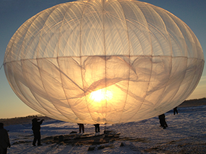

Ici les ballons Loon ont fait la même chose que ce que je proposais: des ballast pour monter et descendre, en version plus intelligente avec le ballast dans le ballon d'helium:
http://arstechnica.com/information-technol...-a-whole-state/
The Loon devices are two balloons in one, an outer balloon filled with helium and a smaller one inside filled with air. “We can either pump air in it, which is going to make the balloon go down, or we can remove the air, which is going to make it go up. That's how we change altitude,” Mathe explained.
Each balloon has a radio for sending and receiving signals and can send its GPS position to the ground so that Google’s mission control software can track it in real time.
Donc un ballon dans le ballon d'hélium et il est vidé ou rempli d'air (qu'on trouve dans l'extérieur par une simple pompe à air) pour monter ou descendre.
Aussi sur la durée:
Google has boosted the balloons’ potential altitude range from about 800 meters to a couple of kilometers, allowing more control over where they fly. Early on, Google could keep the balloons in the air for about five days. Now the average is more than 100 days, with a record of 187. A Google announcement this month gives a sense of how that flight was achieved:
In the same time it took the Earth to complete half of its annual orbit of the sun, our record-breaker managed to circumnavigate the globe 9 times, enduring temperatures as low as -75c (-103 F) and wind speeds as high as 291 km/h, soaring to a maximum height of 21 km and drifting over more than a dozen countries across 4 continents.
Having been in the air for just over 3 months we decided to put the balloon through its paces, making a series of altitude changes on its last circumnavigation to test our ability to fly north out of southern latitude bands. The test was successful and we managed to turn up to the Northern tip of Australia where we were able to access a much slower wind stream going in the opposite direction and sending our balloon lazily back over to South America. Finally, we brought it back into its original southern latitude band to swoop in and land in one of our Argentinian recovery zones for collection.
Donc un record de durée réel de 187 jours soit plus de 3 mois. Le ballon a fait 9 fois le tour d ela Terre, exposé à -75°C et 291 km/h de vent parfois.

Avec des vents de presque 300km/h impossible de rester géostationnaire, il faut laisser naviguer autour de la Terre. Loon fait que le ballon rejoint des couches de vent stratosphérique de direction et vitesse pas trop mauvaises et le laisse naviguer dedans; ils ne changent que l'altitude.
Les infos sur le matériau dont est fait le ballon:
http://www.cnet.com/news/googles-project-l...th-three-times/
Descrochers described the balloon material as rubber-band like, with each balloon requiring 500 square meters of the stuff. While originally the balloons that were tested in Project Loon's demo in New Zealand were made out of polyethylene film, the video makes it sound like Google is still undecided on what kind of material will best suit its balloons.
She notes that Loon's balloons must be exceptionally hardy, because they will be subject to both hot and cold extremes on a daily basis, causing the material to stretch and contract. Ultraviolet radiation and inclement weather are also problems that the balloons must contend with, as they could lead to pinhole leaks and more serious destructive forces.
Donc soit film de polyéthylène dans la première version, soit plus durable, mais plus cher, une bande comme de l'élastique (sur 500 mètres carrés!!)
Résistance à la surpression et aux UV, au froid extrême et à la chaleur; voilà les contraintes subies.
